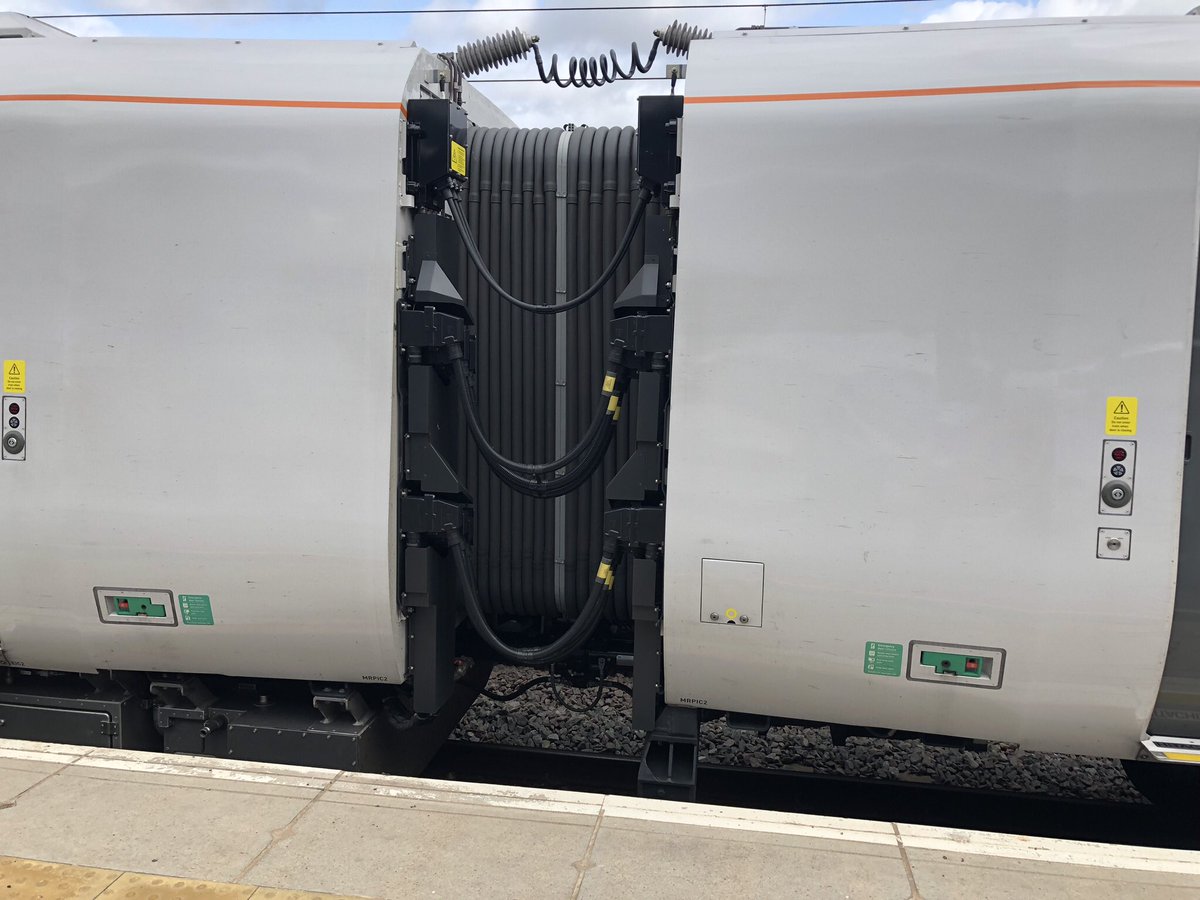

My expectation is that if you have cables like that, where a climb risk is determined, then the cables should only able to support a small downwards load (say 10 kilos) before the connector detaches.
That wouldn't be much good as you'd then have exposed live conductors.
Also a risk that the connectors drop out due to train movement.
Perhaps they will have to put some kind of fairing over then, or daub them with anti-climb paint, or perhaps even move the cabling and piping.
Whatever the solution, it a bit carp that the issue has been raised after entry into service.
I actually think it's a non-issue and typical of the sort of thing that comes out of a desktop risk assessment. I can think of multiple ways of getting into the roof any any train in a station without much difficulty.
But for sure someone is going to make someone else spend a lot of money mitigating said "problem".

It does seem a bit fishy.

I don't think it may be the cables that is the issue, but the step like appearance of the electrical boxes. Perhaps a Pendolino style fairing covering the sides of them will be used, thus leaving the cables where they are but deterring anyone from climbing on the boxes.

It's the cables and their proximity to one another that is the issue. They create, in the ORR's words, a "ladder" like appearance that people might be tempted to climb.
The inter-vehicle connections did not form part of the approval process when the GWR Class 800/2s were approved, but it's since been added as a result of a fatality at Manchester Piccadilly caused by a man climbing on to the roof of a Pendolino using these cables.

If that’s the case that’s triggered the issue, presumably they’ll be looking at 390s as well.

A spokesman explained: ‘The reason is the connectors and the possibility they could be used as a ladder to climb on the roof. Hitachi made some modifications before they entered service with GWR. We are writing to the company to ask for further controls.’
It's not clear to me whether the 'further controls' are controls applied by GWR which have not been applied on LNER, or additional controls over and above what GWR have applied. Either way it doesn't sound like something ORR have just dreamed up.
https://www.railnews.co.uk/news/2018/10/10-december-launch-for-ecml-azumas.html
GWR units had some modifications after introduction, ORR are basically saying the risk is acceptable to keep using already approved units but that they shouldn't allow the commissioning of new units until a permanent fix is available as that would increase the chances.

...but it's since been added as a result of a fatality at Manchester Piccadilly caused by a man climbing on to the roof of a Pendolino using these cables.
Oh yes, I'd forgotten about that. :-\ There was a widely publicised incident involving a passenger climbing onto the roof of a Voyager via (I think) a vehicle end at Durham a couple of years ago that I thought might have influenced the ruling.

There's a similar inter-coach cable configuration on the ETR 470s which are/were operated under the Cisalpino name in Switzerland and Italy. I can recall no account of anyone climbing on the cables to access the roof.

Part of me thinks what is the difference between this and jumping off an overhead bridge onto the roof of an electric train? It happens. We need to start prioritising people using common sense over the threat of litigation.
Honestly, that does look very clime-able, especially so to children and intoxicated adults.

What's interesting is the class 395 SE HS trains are Hitachi AT300s so are the 800/01/02s but the 395s don't have such large gaps, and some aerodynamics to reduce the gap!
Interestingly though, have the 800/801/802s been designed to handle tighter twists and turns further up the ECML? Obviously if they need to handle tighter curves they'll need bigger gaps between carriages and can't have vanity panels placed on the end of each carriage to stop idiots being idiots!

A more obvious difference is the 395 is 20m stock (i.e., each car is 20m long), as is common in the former SR. The AT300s are the first 26m stock to actually enter service in the UK.
