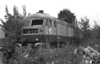

On a slightly more old-fashioned note, the Hawker Siddeley Kestrel (the HS4000):
By Phil Sangwell - HS 4000,Barrow Hill Open Day 1971Uploaded by oxyman, CC BY 2.0, https://commons.wikimedia.org/w/index.php?curid=7064689
from Wikipedia (above and below quote):
Sale to Soviet Union[edit]
The locomotive was sold to the Soviet Union in 1971 for £127,000,[2] being shipped from Cardiff Docks to Leningrad docks by the MV Krasnokamsk[10] in July 1971.[1] On arrival in Russia, Kestrel was exhibited at the Moscow Rolling Stock Exhibition and then was moved to the All-Union Rail Transport Scientific Research Institute at Shcherbinka[11] where it was re-gauged to 1,520 mm (4 ft 11 27⁄32 in), and tested on a circular test railway[note 7] as well as being used on some parts of the Russian rail network.[3]
After testing of the locomotive the engine was removed for static testing, and the locomotive body ballasted for use in high load tests of other vehicles.[12]
The remains of the vehicle are believed to have been scrapped in 1993.[1]
The most powerful locomotive we had. And we sold it to the Russians, where they essentially hing, drew and quartered it for tests.
-Peter
EDIT:
Here is a photo of the Kestrel, apparently from Russia:
EDIT Part 2:
320
Here is another photo of the Kestrel, again from Russia, the final resting place of this engine.
