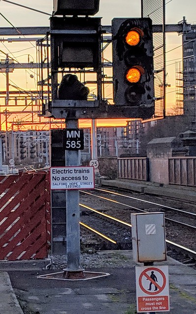

Salford Central does not have these but it does have this warning for drivers at the end of the platform towards Crescent:
by Chris Davis, on Flickr
