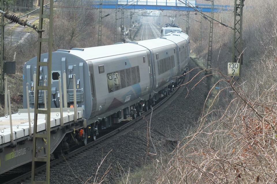

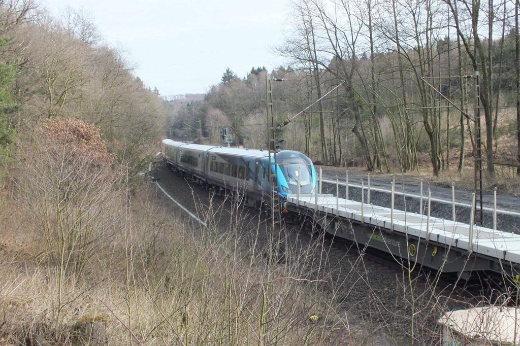

First rake has been seen in transit by rail to Velim in Germany. At least I'm told the photo I have been sent was taken in Germany.
The OLE certainly looks german (assuming the photo is the same - taken from Richard Clinnick's twitter)

Interesting that the non-driving end coach of this stock appears to have structural members where the gangway would otherwise go, and is therefore structurally different from the intermediate coaches. This is unlike the Mk4s where the end coach is the same bodyshell as the others, just with a sort of cover over the hole where the gangway would be.
104,203
Yeah, I noticed that. They seem to have anti-climb equipment bolted on quite high up as well, I guess that corresponds with its location on the 68. They do look very European with their completely flat ends rather than the UK usual of tapering them in (Pendolinos excepted).
I'm not sure I understand the non gangwayed coach end, what would the reason be?
Wouldn't it be better to have the non driving coaches all a standard construction, even if just for operational flexibility?
I don't think it's anticlimb, it doesn't look nearly structural enough if you look at this picture. It's looks like it is just a corrugated cover for something - although what exactly I don't know
